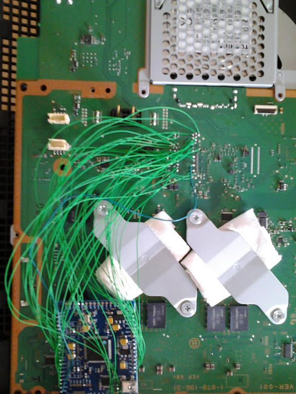

HI
First of all, i want to say thank you to the people who bother with my problem and try to help me to find a solution, even if there are no solution for this crapy programer and my crapy NOR chip.
To 3absiso:
yes, that is a great tutorial.I believe one of the first that i followed at the beginning of my instalation.If you read my last post again you will notice that i mentioned the strange advice for the RY/BY (wich is legended with RDY on the new progskeet diagrams) that i readed before.But has you can confirm that is for PSkeet 1.1, the 1.2 doesn“t even have the GP4 pad.but thank“s for your help
to oGZxFTW - I tryed to enter IRC, but i stopped using MIRC at 15 years ago.I dont even remeber how to change a channel.Could you leave some advice here for a special setup that you mentioned on SPANSION NOR 128P?THKS
To Biozombie Yes, i am really thinking on buying the E3 Flasher or the Progskeet 1.1 (if i buy this one it would be like if i didnt learn anything with my mistakes).What do you think about both of them?Wich one do you think i should buy? I would like to try the 1.1 version but im afraid that i could mess up with the need of removing the R7 resistor and the R8, right?
Ok, has i promisse before, here is two of my installation photos that i taked:
Please, leave your comments.

Your wires look to long and are you using 26awg?
No longer than 10-12cm

Hi
There are two ways of power from the outside ( power Supply PC )and the inside (Ps3 power Supply)
Never connect the power from usb (does not work)
For NOR flash is the best method PS3 power supply ! (I had version 1.1 and no problem)(Write all cable length not matter)
on the length of the cable never had a problem with any NOR
I thought that the new one will be better and bull****.
New is tacky with cheap components
Buy 1.1 is ok and never buy clips
xonsox is offline   Reply With Quote
